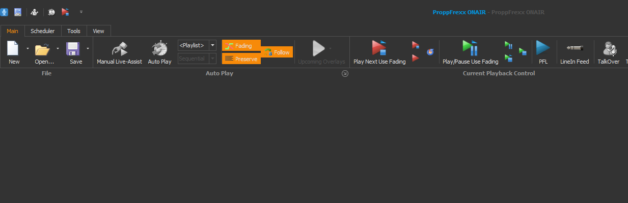

I am testing the demo version since last week and learning the software, but can´t find answer for two questions:
1 – Testing functions on main menu after a few minutes the main menu button disappeared! How to get it back?

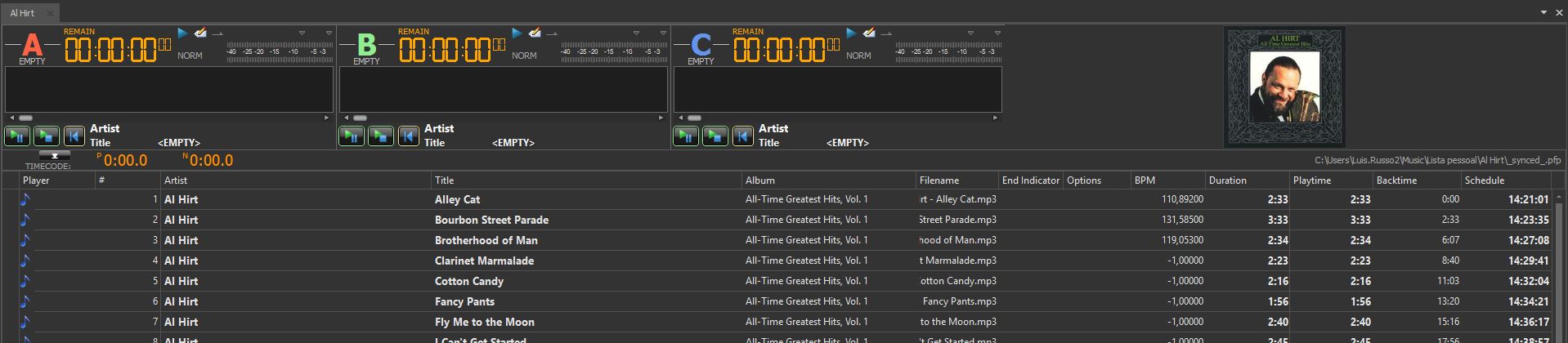

2 – How can I resize just the playlist area without affecting the header?

Re: changing the look
1 : probably you changed the ribbon style.
But the main menu should still be there. Just the big button changed to the menu item.
Maybe a screenshot might explain what you mean.
2 : not sure what you mean?
The playlist area is the main or document area. You only limit its size by either docking other panels to it OR by resizing the main window.

Thanks for your answer.
Please take a look to the attached screen shots.
- the playlist area.
- playlist.JPG (123.91 KiB) Viewed 5642 times
- the button is missing on top left side
- button.PNG (34.95 KiB) Viewed 5642 times
a) No, the main button is NOT missing - it is as I assumed: you changed the 'Look And Feel - Ribbon Style' to the 'Mac Office' style!
So simply change it back to 'Default' !
To do that, go the general settings (F3), section 'Look and Feel' and change the 'Ribbon Style' value back to 'Default'.
b) same here: see my answer above... The playlist area is the main or document area. You only limit its size by either docking other panels to it OR by resizing the main window.
Problem solved.
Bernd, thank you for your prompt assistance.
