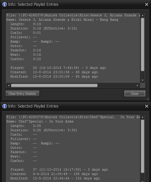

But when the following hit was played a 7.45 this morning and PF planned it again a 11.45 this morning, I checked some of the hits' status and this is what I saw (see image)
The picture above is showing the hit that is planned again while it has played already at 7.46.
The picture below shows a hit that is played 3 days ago! Show I think PF should have planned that song right?

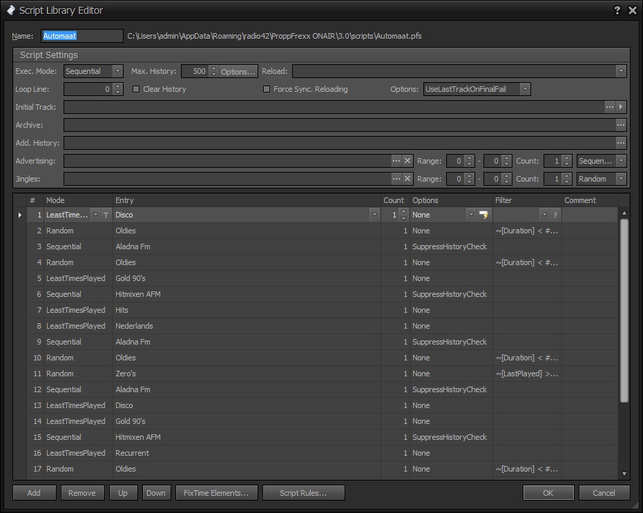

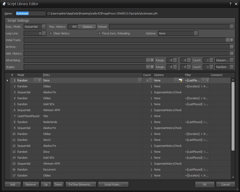

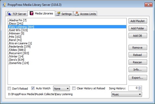

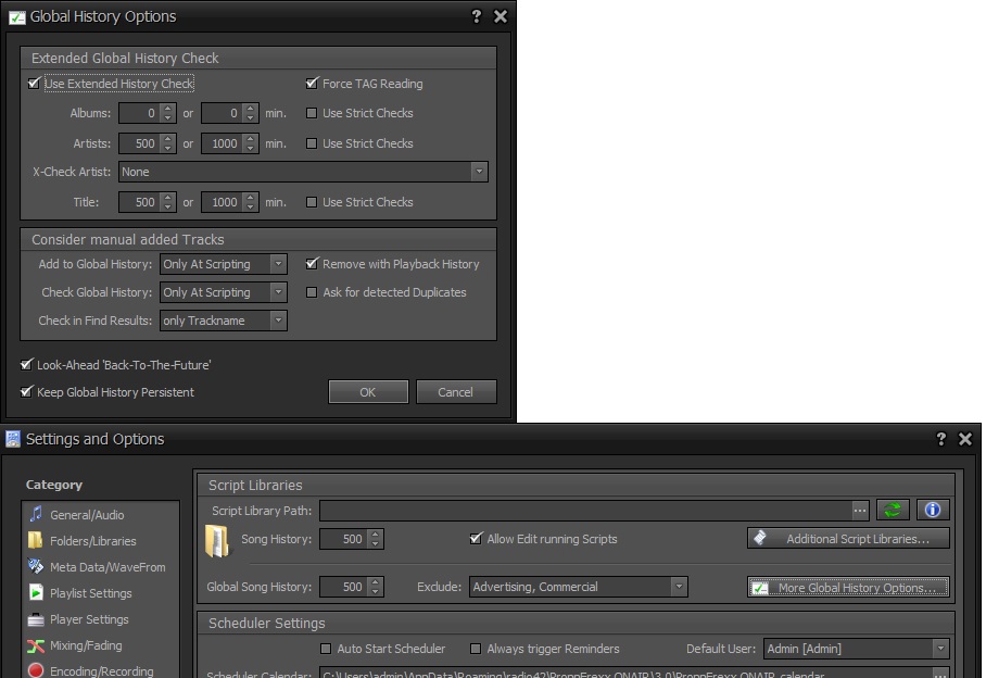

I've added some screens from my settings so you can see if this is good or it need some changes.
Notice that every lib has the same settings: don't reload off, auto watch on, none, clear history at reload off, song history 0
This is our non-stop script.
As you can see it contains the different lib with random option and last played in days filter.
Except the Hits lib, that I have configured to least times played as you suggested.
And these are our global and song history settings and the extended global history settings
Can you take a look for me and give me you opinion about it and what I could change to let it work smooth.
So it will play the music that is played more than 6 or greater days ago. Or the least times played.
Greetz Jesper
I will try your setting for the 'Hits' lib.
Greetz Jesper
Re: How to plan musicfilter Last Played in Days
Thanks for your advice.
I've disabled the song history and the global history is still set at 500 (which is about 24 hours of history)
The script i've edited to this: All media lib containing less than 500 items I have set to 'leasttimesplayed' setting
And the grobal script setting I've set to 'UseLastTrackOnFinalFail'
If I do the other option:
'leasttimesplayed' with 'supresshistorycheck' it will come back with the same least times track more often because it won't check the history right? Or with twice the same artist from different lib?
Greetz Jesper
Greetz Jesper
First you are using a global history and a script history.
This typically wouldn't make much sense; as they are maintained twice and do not really add any additional value - except, that 2 parallel histories are both checked in parallel and make things more complicated.
So I'd suggest to only use the global history.
As a 'rule of thumb' - add the 'SuppressHistoryCheck' script-line option to all script-line using media libs having less entries than your history count - e.g. the 'Recurrent', 'Gold 90's' etc. lib!
Or specify the script global 'UseLastTrackOnFinalFail' option in order to ensure, that those script-lines are not skipped.
