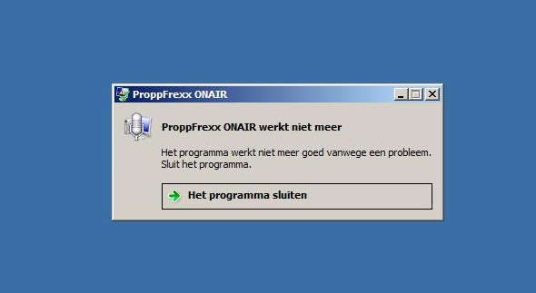

After crash of ProppFrexx and reboot of Windows I can't start ProppFrexx anymore.
It was updating a new version of PFOA and than crash so I can't start it anymore. What do do??
- Proppfrexx does not work anymore.jpg (15.87 KiB) Viewed 11015 times
Re: BIG Problem can't start ProppFrexx anymore
Then check your system - and the Debug Logging!
A crash like this can not be caused by ProppFrexx itself - else there would be an entry in the ProppFrexx Error.log.
If that is not the case, it must be a system component which caused the crash.
If that system component was instantiated by ProppFrexx (e.g. happened within the audio lib I am using) it would have been written to the Windows Event Log.
As all this doesn't seem to be the case, it must be any other OS or hardware component which crashed and made ProppFrexx unstable!
For the next time, if you ever get a crash again:
Please create a dump file from the Windows Task Manager!
BUT: Use the 32-bit version of the Windows Task Manager - as explained below:
http://blogs.msdn.com/b/amb/archive/201 ... nager.aspx
E.g.:
- run this: C:\Windows\SysWOW64\taskmgr.exe
- right-click on the 'ProppFrexx ONAIR.exe' process
- and select the 'Create Dump File...' menu item
- remember the file location where the .dmp file was saved and send it to me
Problem SOLVED: within C:\Program Files (x86)\radio42\ProppFrexx ONAIR\3.0\Previous Version I manually started up "ProppFrexx Updater.exe" .
That solved the problem and ProppFrexx restarted and I could update ProppFrexx. Now we are on air again
