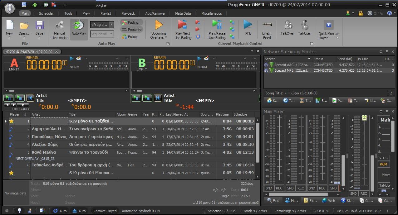

This morning (after 12 days of continuous playback) PFOA stopped playing the playlist resulting in dead air.
No error, no message, nothing.
- 20140724 1.jpg (176.78 KiB) Viewed 13598 times
I am sending you the debug log to check what is wrong.
The last song played was at 07:44 and 30 minutes later I (re)started PFOA again.
Note that I was using the previous version v3.0.14.3
Now before restarting PFOA I updated to the latest version (v3.0.14.5)
