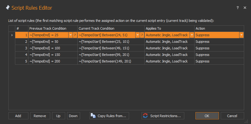

I included a screen dump of my (first try) Script Rule that I created for the smooth transition topic. Can you please feedback if this will work? I'm having a few questions already. In the "applies to" column, I selected "Automatic Jingle" and "LoadTrack". Does this make sure that jingles from the Script Library Editor are also taken into account for intro and outdo tempo? In the "Action" column I selected "Suppress", but honestly I don't understand what this means in terms of results in the playlist. I read the guidance of the two settings, but it's not clear to me. Thanks for your reply.

Re: Smooth track transition
The ‚Suppress‘ Mode means, that the violating track is suppressed and another is tried.
The ‘Defer’ mode means the violating track is pushed back for now (also another track is tried). But the next time all so far deferred tracks are tried first....
In you case ‘Suppress’ is recommended.
The ‘Applies To’ column allows you to limit the rule for only certain script-line modes. ‘Random’ incl. the LeastTimes/RecentlyPlayed.
AutomaticJingle would apply to the script header jingle inserts for example; the others to the related script-line modes.
To figure out why and how the rules and restrictions apply or work, use the ‘Test’ button!
This should also reveal, why certain 0 count tracks are not used in your case.

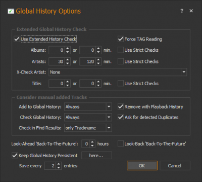

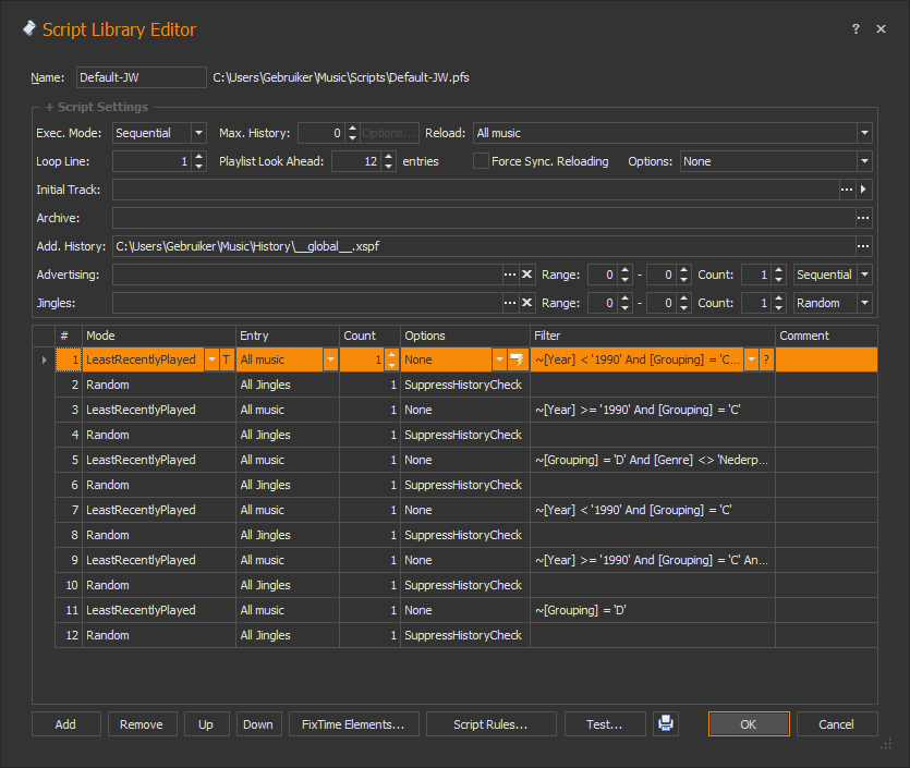

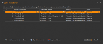

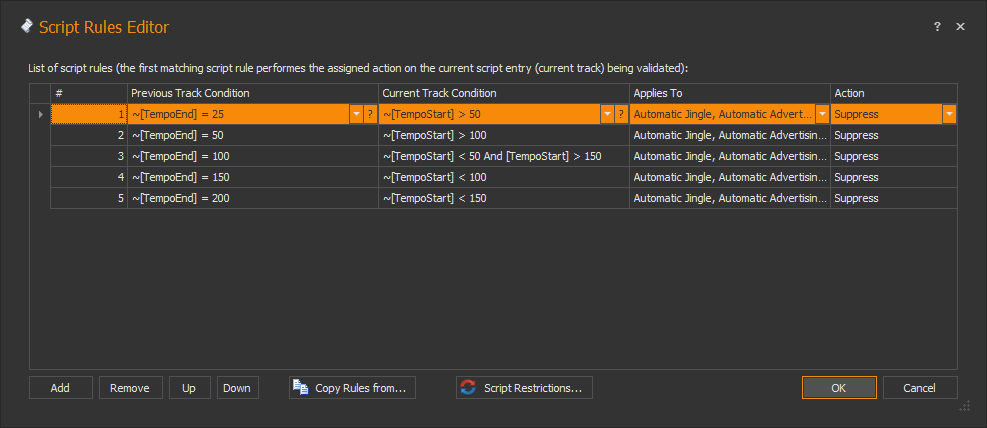

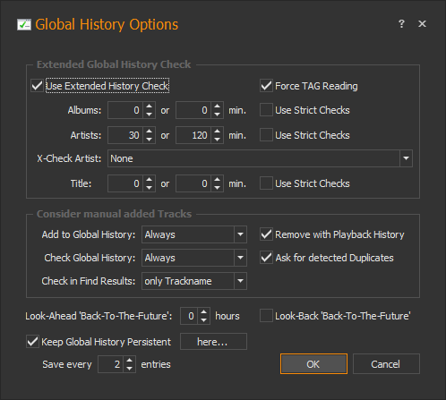

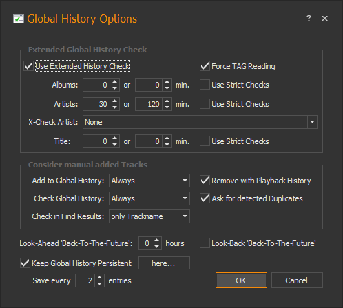

After all tracks have been categorized with start and end tempo, the update to the Professional version to include Script Rules and the definition of these Script Rules, I run into some problems. The first attached picture shows my Script lines. I included the Jingles from the library instead of the cart wall because I thought they would otherwise not be included in the Script Rules. The second picture shows the Script Rule that I created. Now when I run "Test", it takes forever to come with a playlist. I have deleted all history settings except the basic settings (see picture 3). Do you see any reason why this is not working? I have spent hours playing with the settings, but nothing works so far.
Thanks again for your help.
\JW
Your script rules doesn’t sound/look logically correct to me.
E.g. it says: if the previous track has a TempoEnd of 25 AND the current(next) track has either a TempoStart of 25 or 40, than Suppress that current(next) track!
It sounds to me you wanted to express the opposite, I.e.:
If the previous track has a TempoEnd of 25 AND the current(next) track has a TempoStart greater than 50, than Supress ...
You got the difference?! The rule defines when to suppress the current track. Not what is allowed ;-)
Also note, that the ‚Applies To‘ column defines for what type of script-line this rule should be applied, as such you could have placed your Jingles as a Cartwall Lib.

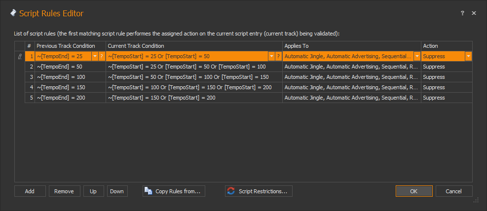

Hi Bernd, thanks once more for your quick reply. That is indeed a big difference! I re-installed the jingles in the cartwall and created the
JWvanGulik
Posts: 166
Joined: 06 Dec 2018 08:13
Location: Netherlands
Post by JWvanGulik »
... Script Rules again (see picture). A much better result, but still some "blind spots". This means that not all script lines give a return, which results in e.g. two jingles played after each other. Do you have any idea where to search for this solution? My standard history is set to Artist history 30 (or 120 min).
