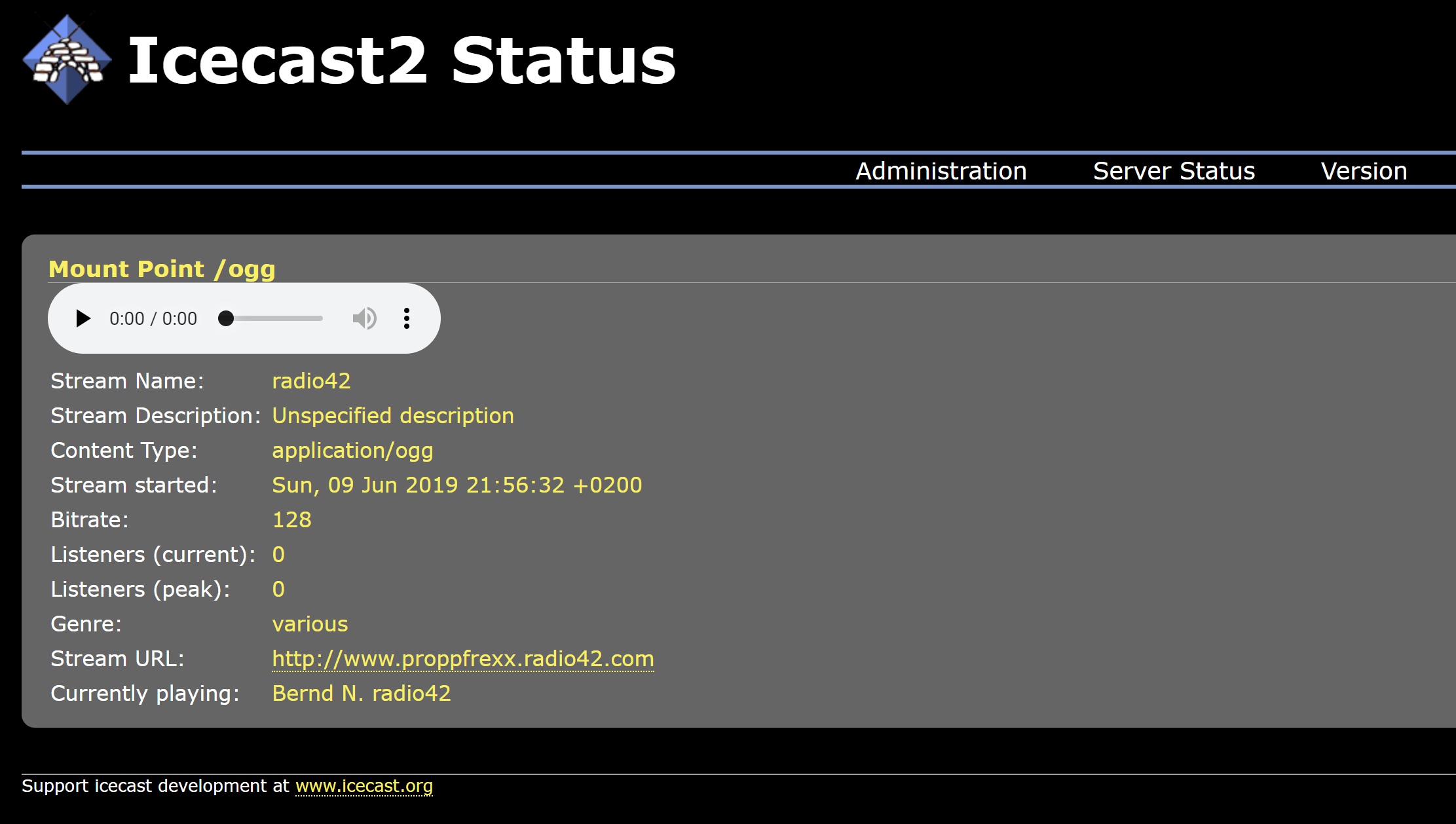

I also tested it with an ICEcast2 server - same result here.
I didn't record a video this time, as the result is absolutely the same. Just attached the screenshot of the ICEcast status page - showing the exact same song title as in the video:

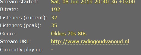

Please see the screen shots.
One is the Shoutcast with the right metadata and second the Icecast with NO metadata.

Re: Metadata

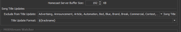

The screenshot looks like you have NOT set the song title format to ${trackname}
The last thing I can offer is a TeamViewer session, but this wouldn’t come for free. See our support pages.
Re: Metadata
This is from the general settings, what about your streaming server configuration?
