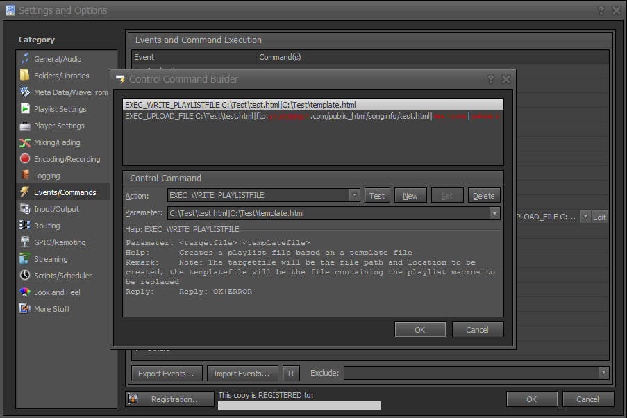

Bernd is a software programmer and not a webdesigner. Below you see a screenshot of the settings that you can use your nowplaying on the website. Goto Events/Commands ==> Streaming ==> OnSongTitleChanged and use the code below.
Be sure to create a file called template.html with the following code, this will atomatically be uploaded by ftp tp your site when the songtitle changes.
Current Track: ${currentartist} - ${currenttitle}
Next: ${nextartist} - ${nexttitle}
Previous played:
${02artist} - ${02title}
${03artist} - ${03title}
${04artist} - ${04title}
${05artist} - ${05title}
This is all help i can offer you, so the rest is up to you to find out.
Good luck !

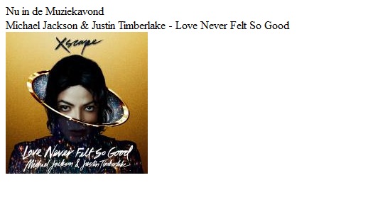

Yes yes yes, got it all working now. I'm going to cleanup code now and will post the solution for other users, so they don't have to struggle like i did
Again thanx, and sorry for constantly asking
