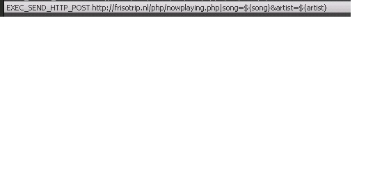

In the command i give a test, and it says OK but nothing on the screen when going to songtitle.html
- screenshot_4.jpg (10.77 KiB) Viewed 15627 times

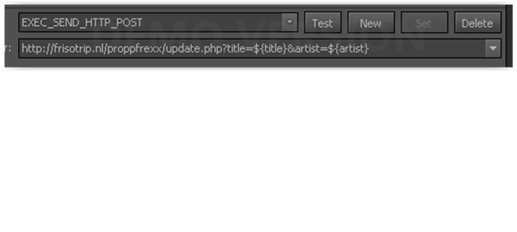

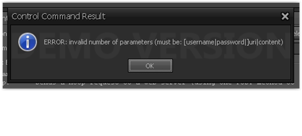

I'm still struggling with the code you give me.
Creating the mysql from the code give an error, and now i manually created the database and the tables in it. Also i found the most settings of the collums. But when created the php files gives me errors during test in proppfrexx.
Also i think that the database connection settings is the config.php file?
- screen_2.jpg (50.28 KiB) Viewed 15720 times
- screen_1.jpg (38.37 KiB) Viewed 15720 times

You need 2 scripts: one for the update and one for the user's display.
In the update script you e.g. insert your now playing track data to a MySQL database table and you invoke this from within ProppFrexx.
In the display script you retrieve the last inserted value back again from that table and display it as a html page...
Here are 2 very simple and untested examples of those scripts:
1. Update Script:
Note, that this script uses another php file, which contains your database connection parameters:
You can then call the update script from within ProppFrexx like this:
The display script for the user (to which you display the now playing content) might look like this:
That's it - roughly...
The database table might look like this:
