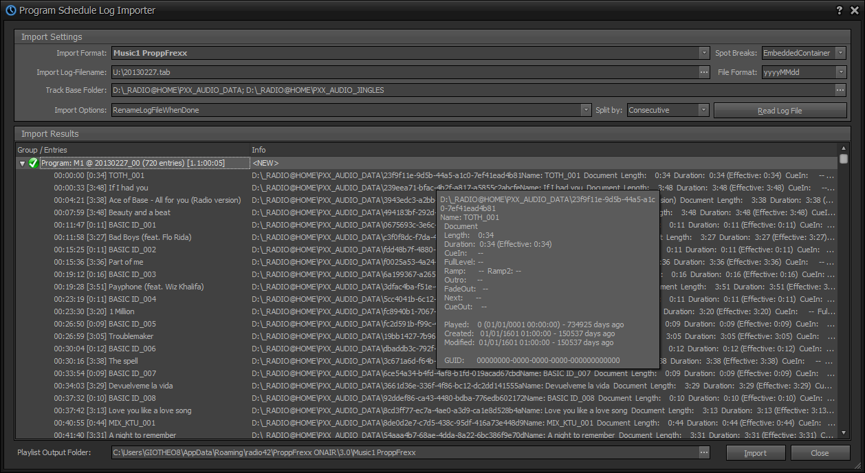

When importing within the scheduler, I put those parameters :
  • Import Format : Music1 Proppfrexx
    Import log-filename : the path where my 20130227.tab is stored.
    Track Base Folder : D:\_RADIO@HOME\PXX_AUDIO_DATA;D:\_RADIO@HOME\PXX_AUDIO_JINGLES
    Import Options : only "RenameLogFileWhenDone"
    SplitBy : Consecutive
    SpotBreaks : no change
    File Format : yyyyMMdd
After "Read Log file" button, all elements appear into the "import results" area. A green "check" in front of "Program : M1 @ 20130227_00 (720 entries) [1.1:00:05], and below, all the element, but without green "check". Hovering my mouse pointer onto the element, the tooltip seems to indicate that the file had not been found : no filename, no cue points... nothing.
When I click to "Import", the pfp playlist is created but we see clearly that the location is not okay.
Could explain me where I'm wrong ? or if it exists a bug ?
I first thought there is a problem with the "_" and "@" symbol within the name of my audio folders. But as I removed them for testing, there had been no better results :-(
Regards,
Sylvain
Theo, from France.

Re: Music 1 integration
I'll take a deeper look into your provided sample data later...but at a first glance, it seems, that the GUID in the log file could not be resolved propperly to a filename.
I'll need to make some tests to see what might go wrong...
Should now be fixed in v3.0.11.36!
