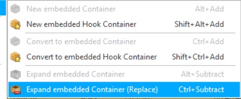

And what do you put on the T in script so that the container can also read the track name?
${artist} - ${title}
Already tried the above but this does not work.
Can you click somewhere in the script that you can automatically execute the following? Expand container ?
Re: Play the same media type in cartwall and music libary
That doesn’t work. The container T title can not grab any data from the container tracks.
Just don’t create a container in the first place.

Expand container manually executed. Could this also be done automatically?
However, you can already do so much with Proppfrexx.... we may sometimes be looking too far! It is certainly a great program!
No, containers can only be expanded manually.
