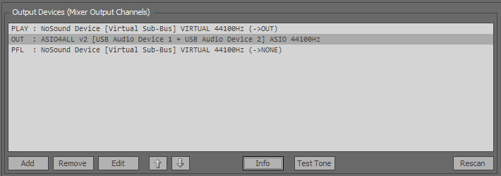

Re: ProppFrexx ONAIR already running
Yes, I did - on all my Test-Hardware it works, without any issue.
Are you mixing the different driver modes on different mixer channels (ie. ASIO and WASAPI)? If yes, you should not do that, that might lead to lags and other problems.
You should stick to only one driver model, i.e. use ASIO for ALL mixer channels or use WASAPI for ALL mixer channels.
No, I'm not mixing the drivers (see attachment of the test machine).
- Output Devices
- Screenshot 2025-12-14 225457.png (11.04 KiB) Viewed 28897 times
