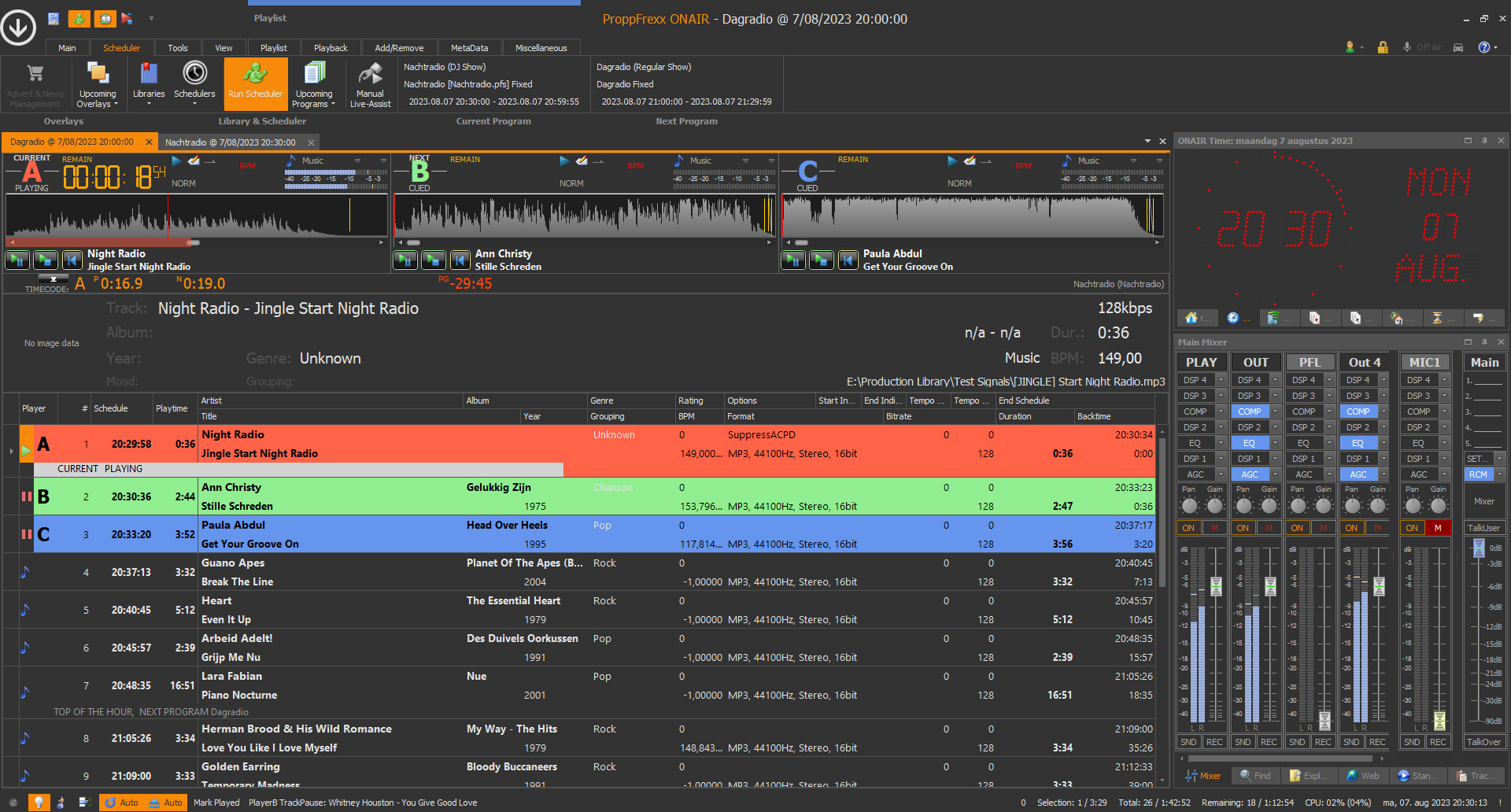

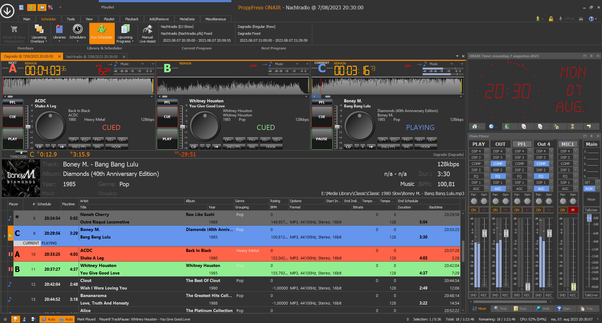

What you are saying about the third point that I made, is 100% correct, but when the time after the last song is less than the Minimum Bridge Time, then the Bridge Track will not be played. ProppFrexx just starts the next program. I guess, I must have an incorrect setting somewhere.
I have now have set the “Show Seconds In Advance Time” to just under the length of the end tunes like you said.
For the end of the day radio (in the night radio Program) I use a tune that is 3’03” long. This is now set to 180 seconds.
This technique I also use to go back from the night program into the day program with another Bridge Track.
For the end of the night radio (in the day radio program) I use another tune that is 4’03” long. This is now set to 240 seconds.
I had set this "Minimum Bridge Time" to -90 seconds with the adjusted settings you suggested, and then the Bridge Track is almost never played. It jumps to the next program when the last song has been played. I even had the two test programs running at the same time today.
When I adjust this Minimum Bridge Time to -60 seconds it runs a little bit better.

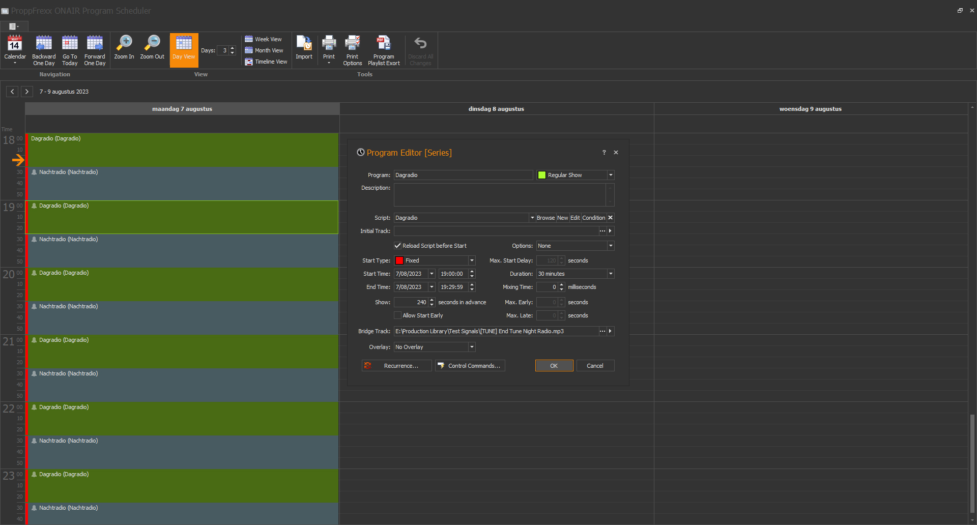

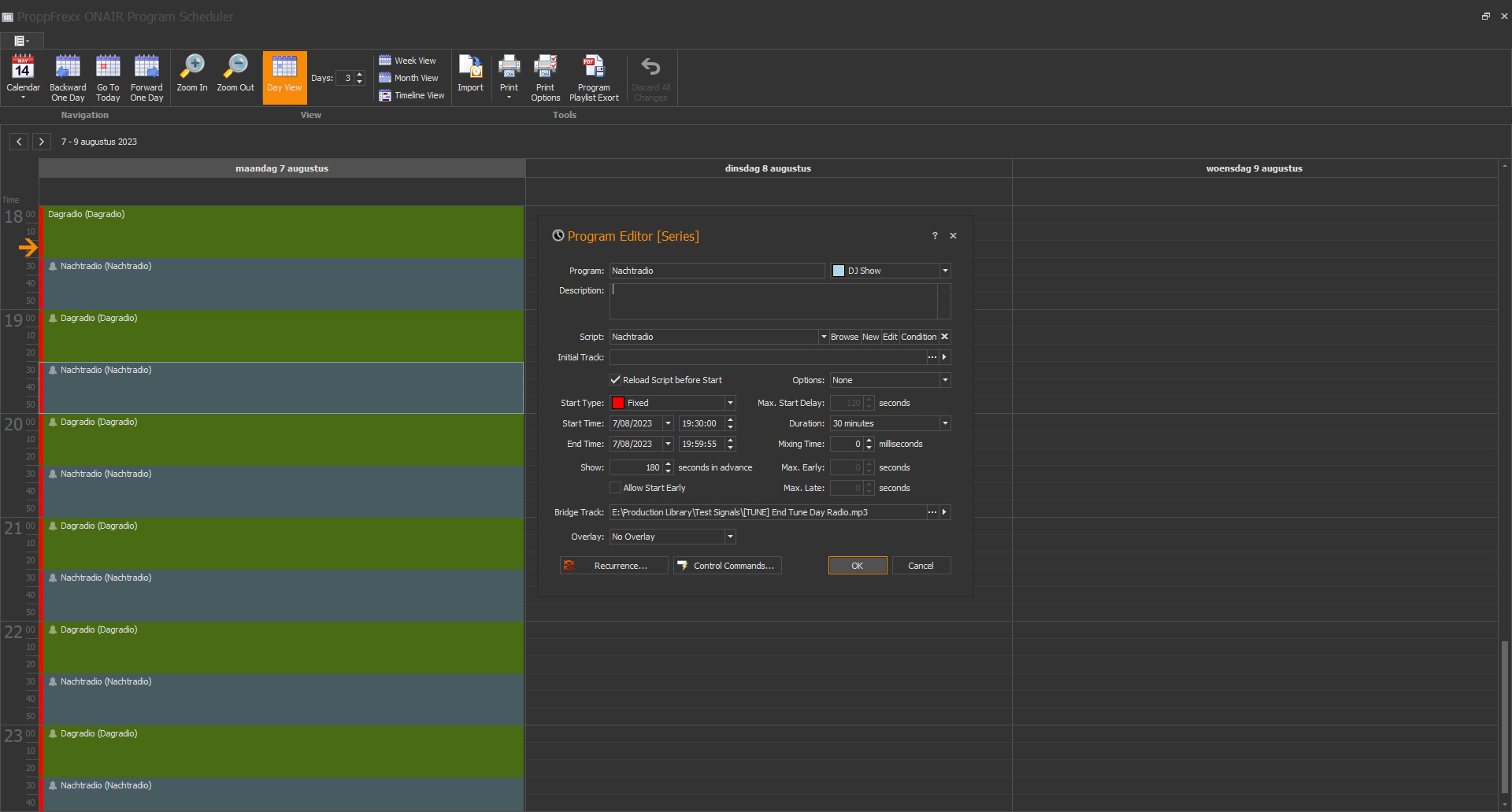

I included the settings of the test programs that I am using. Probably I have set it up in the wrong way or have forgotten something. For a newbie the software is extremely powerful in comparison to others, but also were overwhelming with all the settings and possibilities.
I also have to mention that in the Overlay Scheduler I have setup a Time Signal every hour starting at XX:59:55. The famous six beeps.
The Fixed Time Element I tested before. But as I remember it plays the complete tune. Honestly not what I want.
What I am trying to achieve sounds actually really simple, explaining it is difficult, and making it work in the software is even more difficult because there are so much combinations and variations that can be generated by the software.
• The end tune has to be played at the end of the day radio program. This Program ends at 23:29:59.
• It has to end with the ending of the tune, not somewhere in the middle, at exactly 23:29:59.
• When the last song of the day radio program has ended, the tune fades in and ends at 23:29:59. When the tune fades in, is different every day because of the script that chooses the songs for that program.
• It has to play for example at least 60, 90 or whatever seconds. When the last song hasn’t ended by that time yet, this song should fade out and the last 60, 90 or whatever seconds of the tune have to fade in and play until 23:29:59.
• The night radio program start exactly at 23:30:00.

Minimum Bridge Time:
Defines the minimum time in seconds an optional program bridge track should play.
If the remaining time (til the actual start time) of a program is less than this time, the bridge track will NOT be played and the program will be started early.
Ie. you should set the minimum bridge time to eg. -5 sec. or -10 sec. As it define the time a bridge track is played at least.

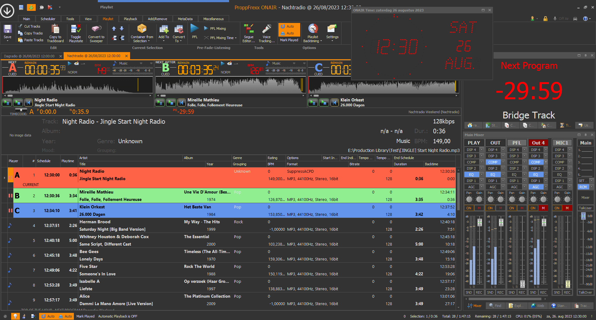

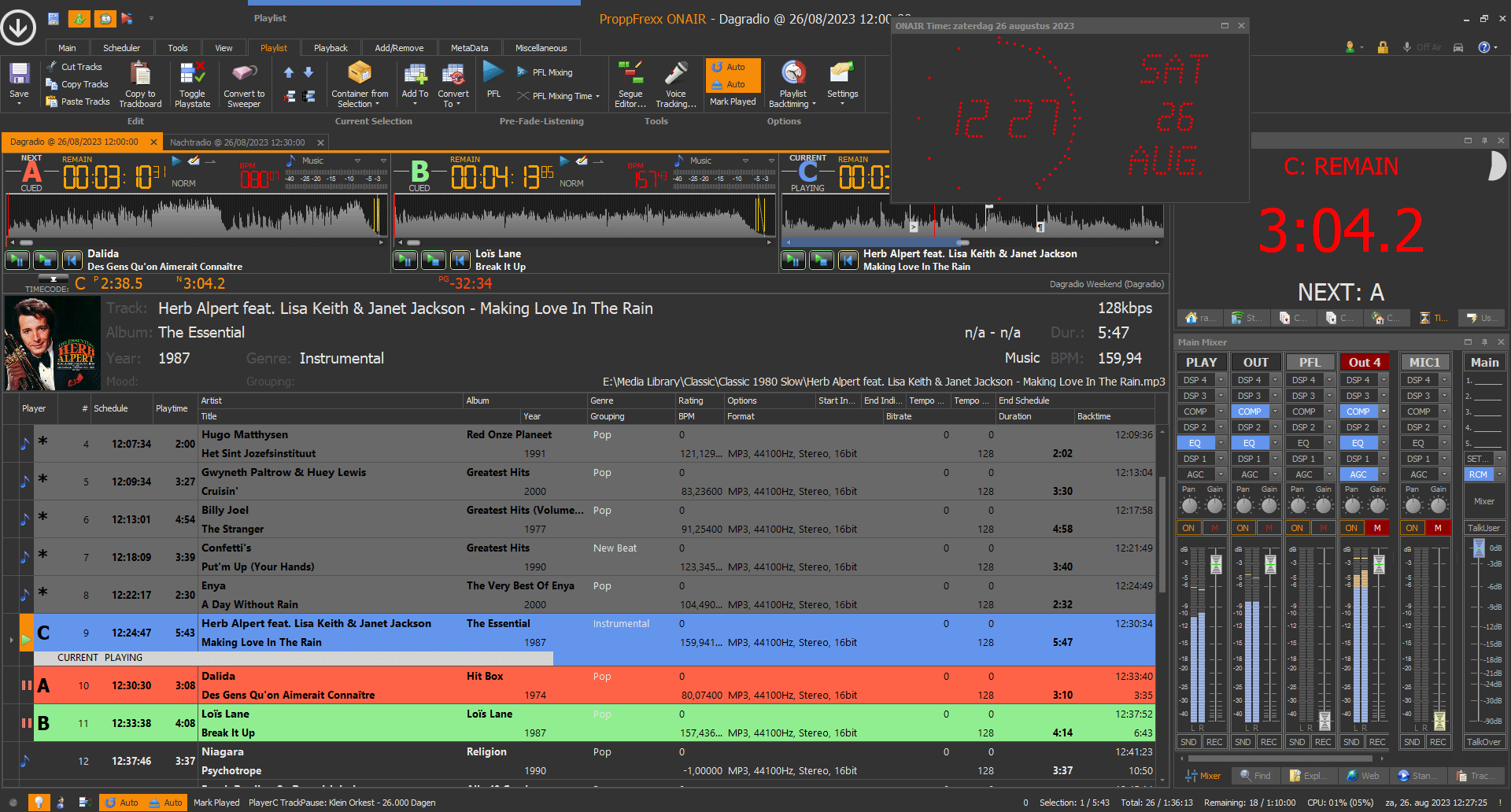

The only tiny thing that I discovered, is that when the last song starts before the next program is loaded, and exceeds the TOTHH time (see screenshots), the Bridge Track doesn’t end exactly at xx:29:59. It runs about 2 or 3 seconds over the half hour. The next program then also start this amount of time later.
The Minimum Bridge Time is set to -150 sec.
In all the others scenarios, when the next program is already loaded before the last song ends, it always (as far as I could test it long enough) ends correctly at xx:29:59 and xx:00:59:55 just before the TOTH Time Signal.
I also noticed that you have implemented a visual notification in the Timecode window when the Bridge Track is playing. Fantastic!
- The next program (Night Radio) isn’t started yet at 1 second after the half hour (see clock). The timecode from DJ Player A is still at 0:00.0, and the progression bar for the Current track (A) in the list hasn’t progressed. The meters in the mixer are still bouncing with the last second of the Bridge track.
