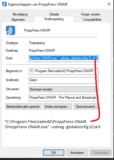

Desktop icon comands:

If your global folder contains no space, this should be okay, else I suggest to put quotes around it:
"C:\Development\BASS_x64\ProppFrexx.UI\Samples\CS\ProppFrexx ONAIR\bin\Debug\ProppFrexx ONAIR.exe" -usbreg -globalconfig "Q:\4.0"

I think the " " solved the problem, I have changed it to:
"C:\Program Files\radio42\ProppFrexx ONAIR\ProppFrexx ONAIR.exe" -usbreg -globalconfig "Q:\4.0"
