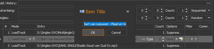

I have tryed: ${trackname}. As you can see the title is now correct but now before the title there is the word "Pro Tools". That word is not what I have entered. I am a little bit confused.
- Meta.jpg (10.3 KiB) Viewed 15185 times

I’ll look into it, but this sounds strange, as the ${trackname} macro resolves also to “Artist - Title” but honors any missing artist or title.
It now looks, like your track uses the word “Pro Tools” as the Artist value?! Can you check this?
But if that is the case, it should have been used before as well! Or are you testing with different tracks?
So maybe you should tag your Jingles or news correctly.

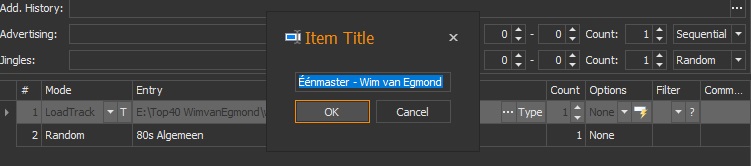

Re: Metadata
In my tests here and also with your file it works as expected.
Are you sure, that you still specify an alternative song title within your script-line using the ‘T’ button?
