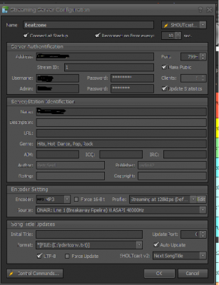

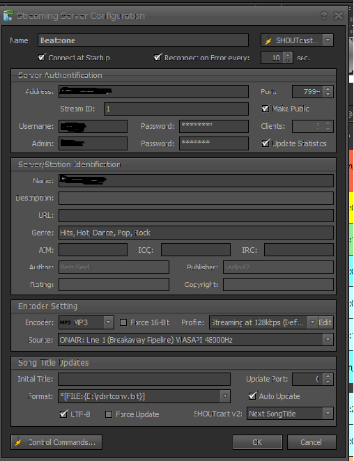

If I put macro to the Format column, doesn't work.
I'm probably doing something wrong ;)

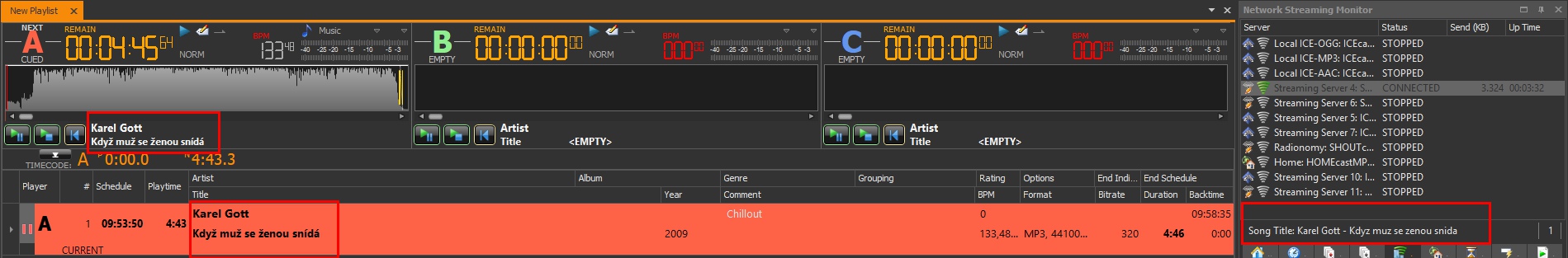

I just see, that there is indeed an issue with the *[FILE: macro.
So please also try to put the following into the format:
*[STRING:{${trackname}}:{norm}]
Here is a screenshot from my tests:
As you can see, the above macro replaces the diacritics as needed.

Works perfectly. Thank you very much
