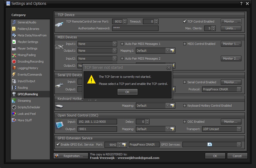

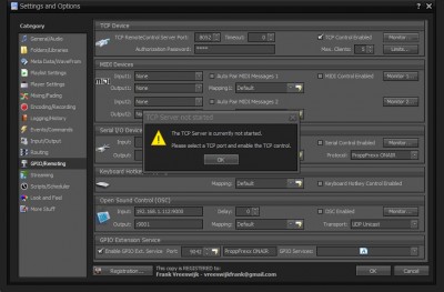

I get the included error message when I want to start the TCP monitor in proppfrexx.
Can you tell me where I can select the TCP port and enable the TCP control?
I now have the idea that the problem is in proppfrexx itself.

In the general settings all looks okay. The problem is for sure not within ProppFrexx, as it works for hundred of users including your other instance, where you reported it has no issues.
The message might also comes up, if the TCP Server could not be started.
Have you checked your Firewall settings, your Anti-Virus or Defender settings etc. to me it looks, as if some other system blocks the given port on the OS level.
E.g. try to disable temp. your Firewall and Anti-Virus to see, if that is blocking anything.

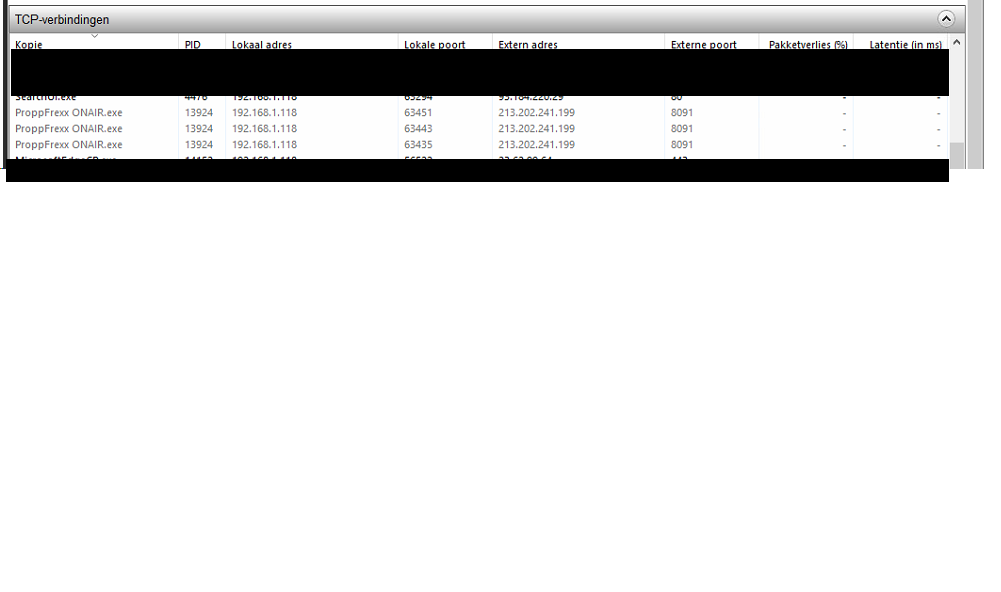

I have an ICT specialist look at it.
all virus scan and firewall are turned off.
the port 9042 does not exist in the TCP connections. It is not activated by proppfrexx, so the GPIO client can not connect.
would you otherwise be able to take part in a teamviewer session?

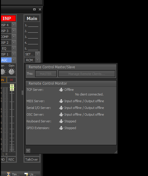

- go to the general settings, section More Stuff and activate the 'Debug Looging' - click OK
- now go to the Mixer panel and click on the 'RCM' popup button - the Remote Control Master/Slave window appears (like shown below)
- is the 'running' icon green next to the 'TCP Server' and 'GPIO Extension'?
- regardless, make a double-click on the two icons (as indicated in the image below) to deactivate and react it, e.g. from Online to Offline and back to Online
- now go back to the general settings, section More Stuff and deactivate the 'Debug Looging' - click OK
Now please send me the "Debug_....log" file generated, which is located in our ProppFrexx AppUserData folder
(e.g. %appdata%\radio42\ProppFrexx ONAIR\4.0)

Everything is turned off in the RCM. I can not turn anything on if I double click.
