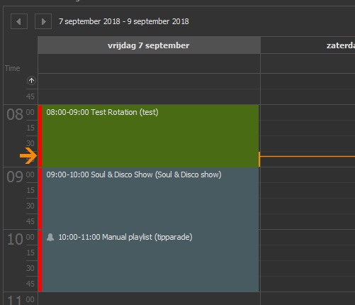

The track is not loading at all. I also have scheduled a manual playlist and this either works. See attached how i do it.

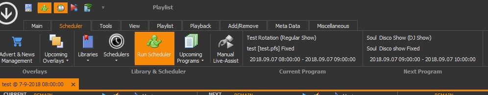

Re: Manual playlist scheduling
Post by Radiofreak »
see attached

I have waited to 9 and 10 a clock. The soul & Disco show is not showing up in the playlist. The first scheduled rotation from 08:00 hours keeps running.. At 10:00hours de manual playlist is comming up fine.
In the DJ Player the Soul & Disco show was not loaded.
So far the rotation and the manual playlist script is doing his job. Now only the Mp3 file has to work and then i am complete so far for starting off.

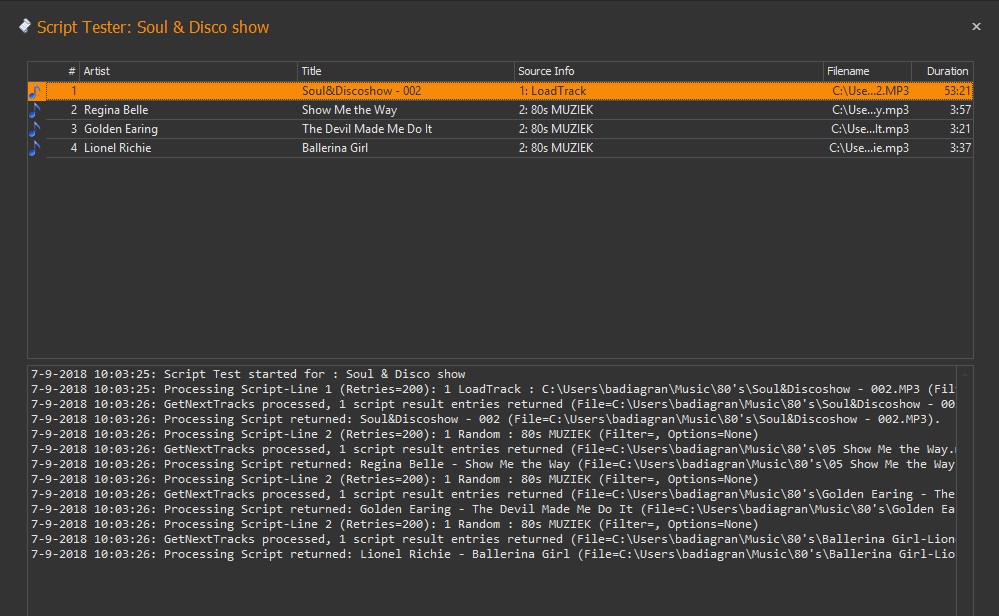

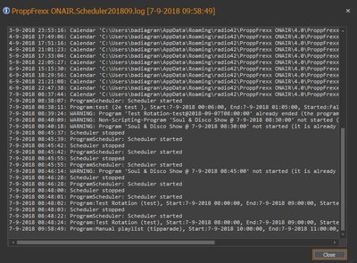

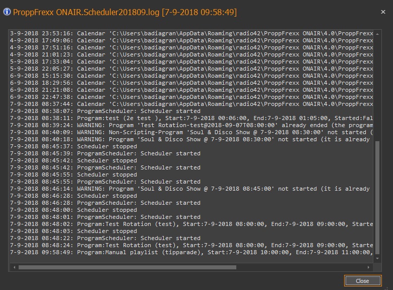

see attached

Unfortunately I can not get much info from the screen shots, as they basically only show the program scheduler entries.
Looks like the current time is before 9:00am - and the next program (your Soul & Disco show) is scheduled to start at 9:00.
So what did exactly happen at 9:00 ? Or did you not wait until the due time?

Alternatively you might also (from within the script editor) - click on the 'Test...' button and send me that output.
Posts: 9155
That means, that your script is fine, but that the program scheduler entry was not loaded/started.
You might determine why, when you go to the Tools ribbon tag and click on the 'Show Log-Files...' ribbon button and select the Scheduler-Log view and than open the related scheduler log file for that month.

Well, it seems, that you haven't configured the program scheduler entry correctly - the program entry was different from the screen-shot you send before.
a) it was scheduled to start at 08:30 and thus it started late at 8:40 (late programs wouldn't start)
b) it also looks like you have forgotten to select the Script!
