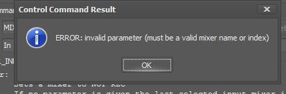

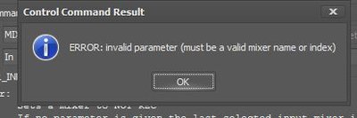

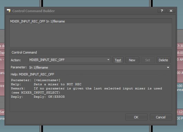

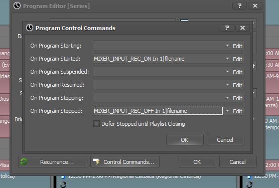

Hello Thanks for answer me i try this script ( MIXER_INPUT_REC_ON In 1|filename) to start automatic recording signal on my mixer In1 and that work perfect thanks, but i want set the same scrip to stop when the program stopped using this script ( MIXER_INPUT_REC_OFF In 1|filename) and I have a error please see attached pic to see my setting
Re: Unwanted broadcast record
When you look at the screenshots you should recognize, that the ..._OFF command ONLY takes the mixername as a parameter. So you must remove the filename from your command, just as the error message suggests.
Note, that all commands are also listed and described with its parameters in the Appendix of the user manual.
