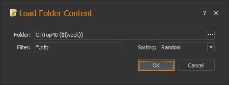

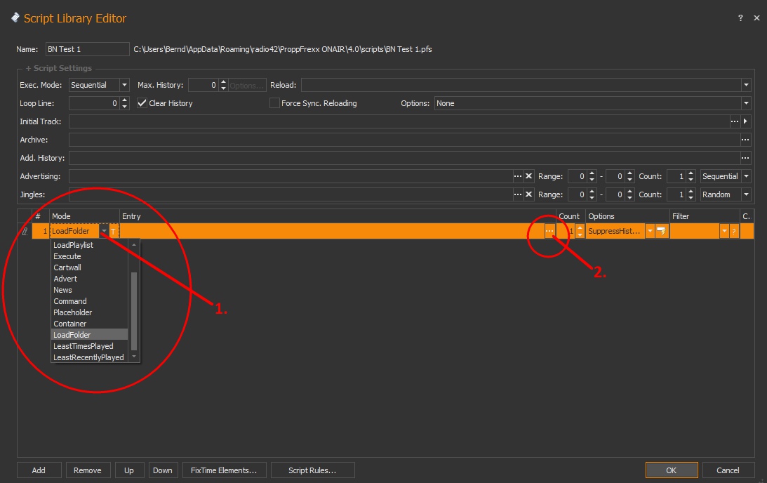

Here are the steps to create such a script-line from within the Script Editor:
1. Select the LoadFolder mode and then 2. click on the '...' button next to the Entry cell.
Select a sample folder, set the sorting to Random and specify *.pfp as the Filter.
Replace the week number with the ${week} macro in the folder path and click OK

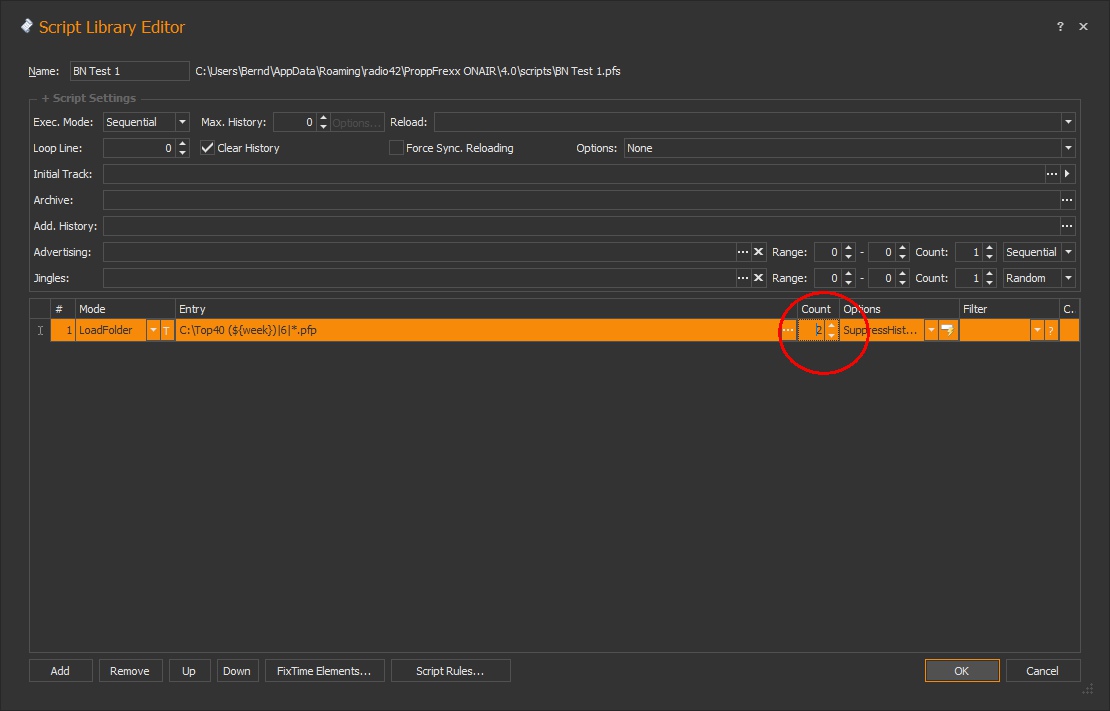

Select 2 as the Count value.
Re: PFP and scheduling

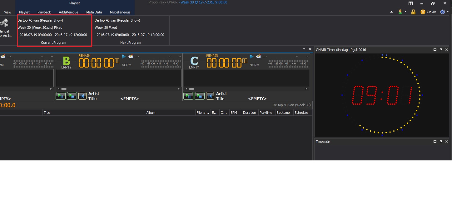

Thxs 4 the info, but,..... it doesn't work.
PFP 2.jpg (127.1 KiB) Viewed 17201 times
We set the time and did everything but the script is not running.
Might there be a possiblity that the map structure or even the media library structure is not working?
But on the other hand is that strange, after all the script overruls all librarys etc, is that correct? Anyway,.... i need your help again. :roll:

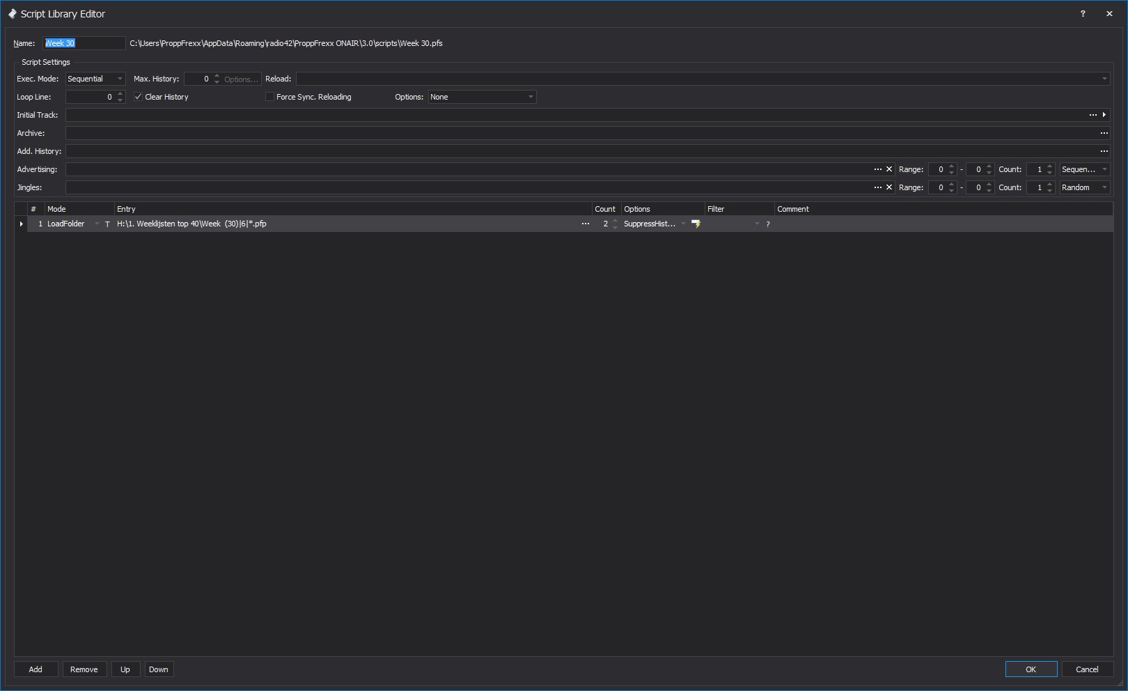

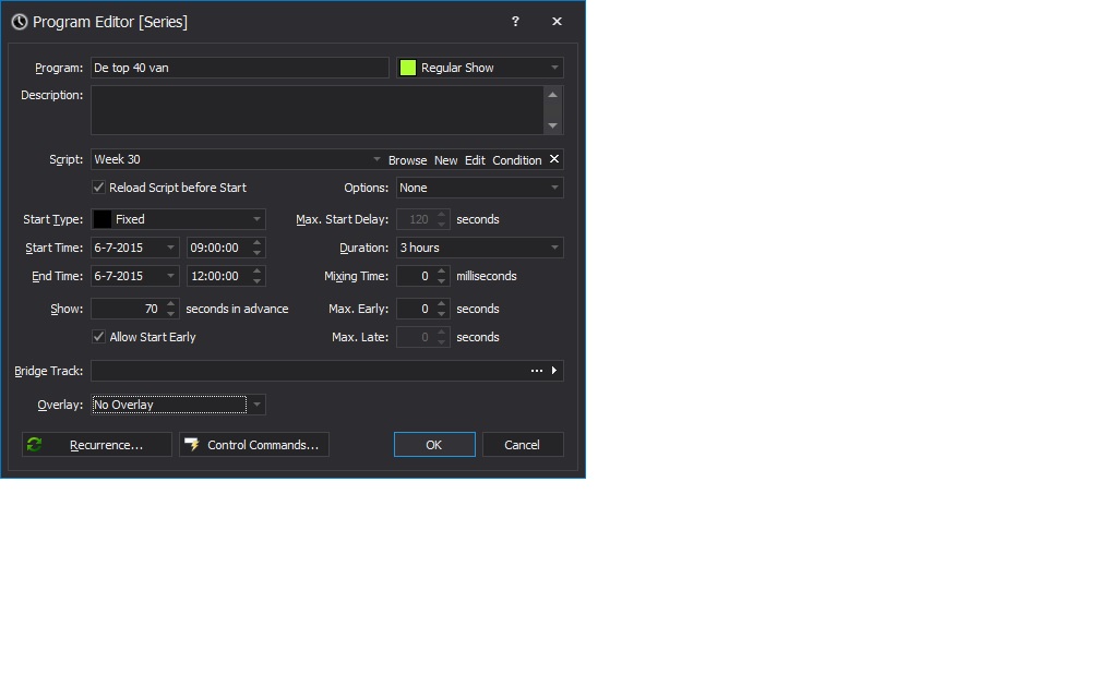

Hereby, ohh that info. A lot to process :D
Script
Scheduler

Then please so post your script AND program scheduler entries (e.g all your related screen shots), as you probably did something wrong in your setup!
