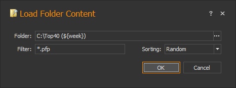

Re: PFP and scheduling
Yes, that looks okay.

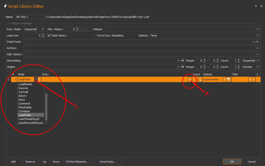

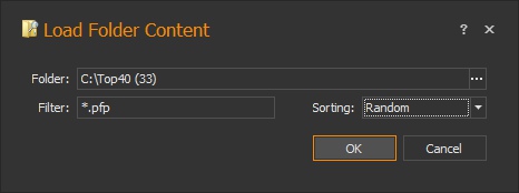

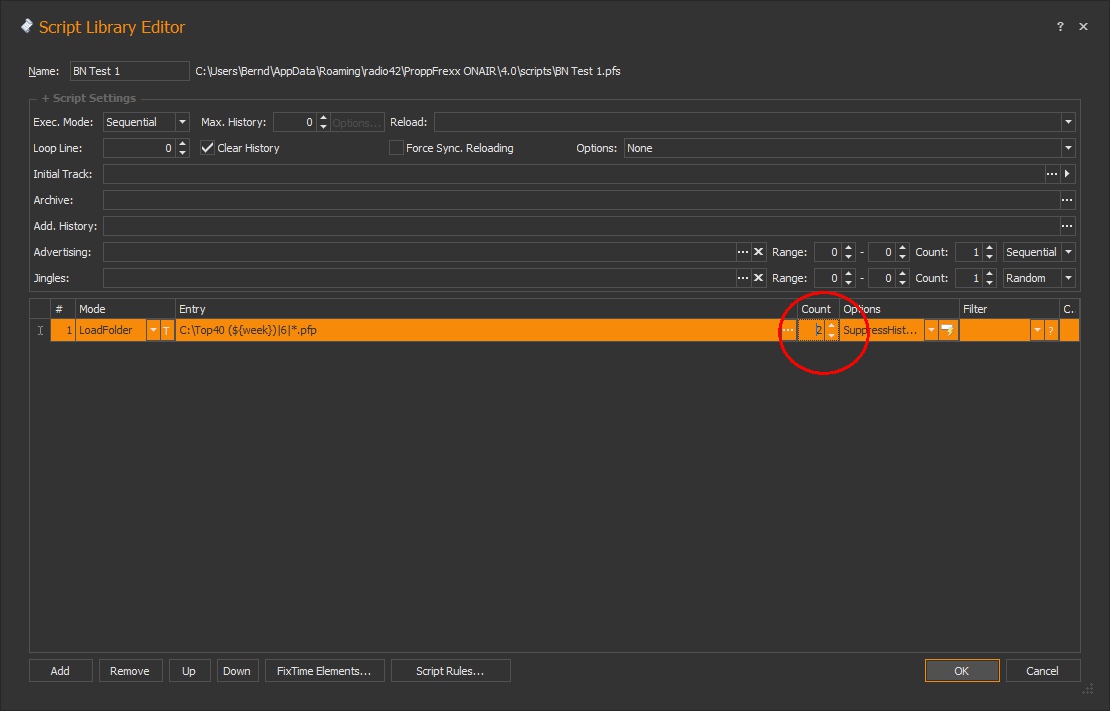

Here are the steps to create such a script-line from within the Script Editor:
1. Select the LoadFolder mode and then 2. click on the '...' button next to the Entry cell.
Select a sample folder, set the sorting to Random and specify *.pfp as the Filter.
Replace the week number with the ${week} macro in the folder path and click OK
Select 2 as the Count value.

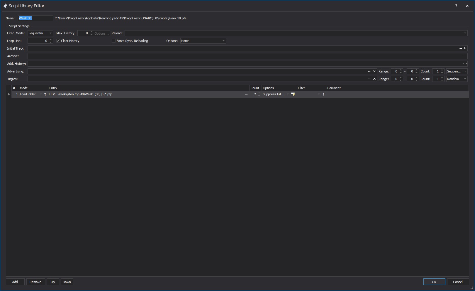

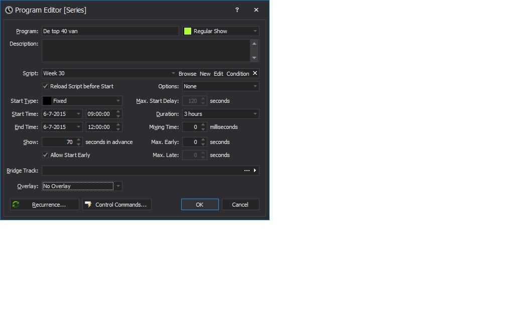

Hereby, ohh that info. A lot to process :D
Script
Scheduler
Program editor.jpg (70.32 KiB) Viewed 17189 times
Then please so post your script AND program scheduler entries (e.g all your related screen shots), as you probably did something wrong in your setup!
