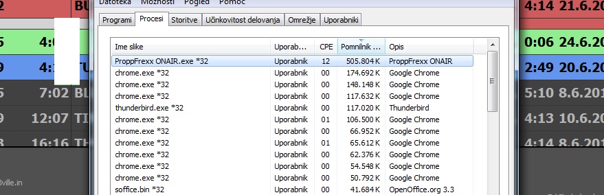

I still have problems.
- ml.jpg (86.41 KiB) Viewed 11693 times
- propp1.jpg (56.57 KiB) Viewed 11693 times

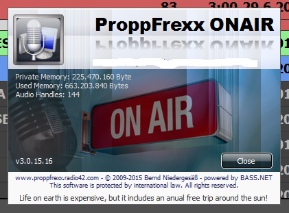

That must then be your PC - the memory leak is definitely fixed.
An Out-of-Memory exception simply happens, when there is not enough free memory available.
Look at your screen shot - ProppFrexx currently uses 225 MB memory and used in total 665 MB.
Those numbers can simply happen, that is NOT a memory leak.
To further know, why this happens, I would need to know your PC setup, total memory, OS version, how many other apps are running in parallel and how much memory they consume, how many tracks you are holding in total in all your media libs, if you are already using the Media Library Server etc. etc.

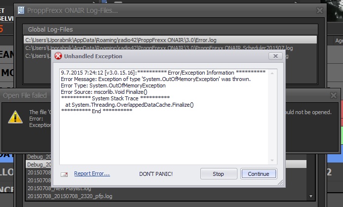

Re: Memory Leak
Hello Bernd,
again, I have a few problems, namely at three o'cloock every night Playlists stops playing it proceed at 5 in the new script. When I try to look at Debug it send me an error message.
- pf1.jpg (171.68 KiB) Viewed 11685 times

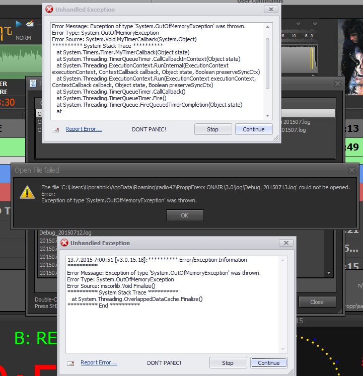

Re: Memory Leak
Disaster...What do you think this might be ?
- pf2.png (73.36 KiB) Viewed 11221 times
