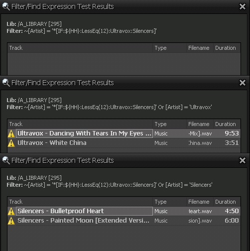

Bernd thanks for the additional info - I see the potential of what can be done with this IF function. However, I'm having trouble getting the IF to resolve in the filter. I tried doing something super simple as a test, screenshot below the IF should have returned either 'Ultravox' or 'Silencers', and there are definitely results in the library as illustrated by addition of the Or conditions.
- if_filter.jpg (83 KiB) Viewed 14786 times

I am sorry, but the macros are currently ONLY working within the scripting, but not in the Find Expression builder.
This because I first wanted to provide something for you to play with and then integrate it into other elements as well.
E.g. the track macros (${genre} for example) wouldn't be available in the regular find, as that would have access resp. wouldn't know anything about a 'last scheduled' track.
So to test the macros within the script-line filters you must actually use them and test them, with a real running script.

In v3.0.14.4 I have now added support for the macro filters (conditional filters) also for the script rules as well as for any Find Window.
So you could now also test your macros in the Filter/Find Expression Builder...
