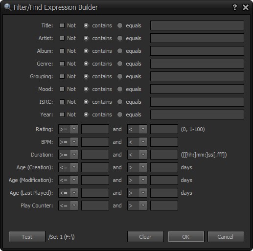

I mean how can I set the correct filter on this screen to do what you were talking about. (Choosing least played.)radio42 wrote:What exactly do your mean?
Do you mean: How to define a filter for a script-line? If yes, just click on the '?' icon in the 'Filter' cell of the related script-line. This invokes the Find Expression Builder dialog which allows you to define filters.
*Can you make a screenshot with the correct setting for me. Thanks

You might for example specify "Play Counter < 1" or "Play Counter < 2" to get a list of tracks matching this ... 'LastTimesPlayed'.
If that list is empty increase the range.
Or specify "Age (Last Played) > 400" to get a list of tracks matching this ... 'LastRecentlyPlayed'.
Note, that there is no direct way to search for 'LastTimesPlayed' resp. 'LastRecentlyPlayed' as that wouldn't return a discrete and finite result set.
But I just see, that the operants for Age and Play Count are not perfectly aligned with the other operants, so I might change that in the next version.

Try the new v3.0.14.01 - it aligned the Play Counter and Age settings.
So just enter "Play Counter < 2" as a test to return the least times played tracks (having a play counter of 0 or 1).

Ok, thanks!
** I tried doing the script thing first because I wanted to learn how to do this, but it seems to have no effect.. Can you post a screenshot with a correct setting. Thanks!
