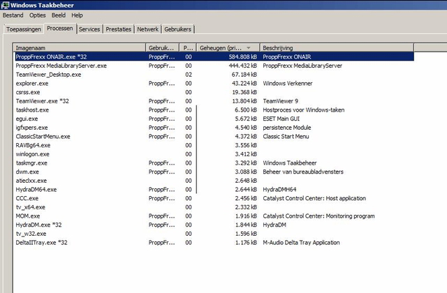

Memory use increases to 557 MB...
We're not using internal Web-Browser, the RSS-Feeds, PDF/Doc-Viewer any Visuals or any other 3rd party DSPs/VSTs.
We're using an ATI FirePro 4800 graphics card with 2 monitors. During dj shows everything works well.
After DJ shows when monitors are off we had the troubles.

I mean those crashes happens when auto-deejay is on: no regular (read manual dj shows); so the PC monitors are off.
Just checked memory consumption: now it is 585 MB for PF, so still increasing since last viewed at 10:35h.
Attached a new screen capture; there aren't any more services running 24/h a day.

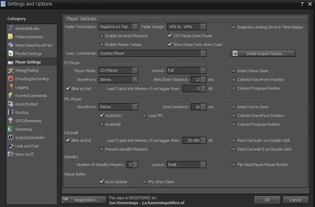

I saw you asked for some other questions in the same kind of thread with the other radio station:
What are your memory limits for the DJ PLayers? - see attached screencapture

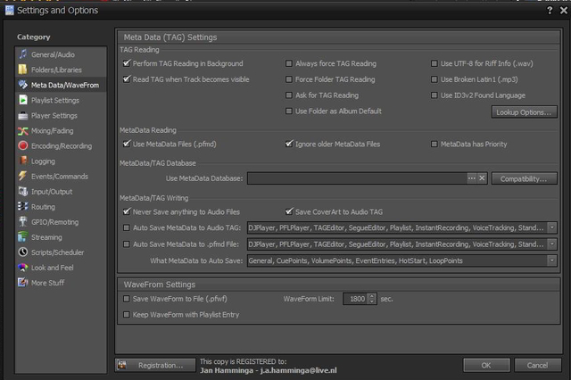

What are your time limits for WaveForms? - waveform limit 1800s
Are you using any histories, what are the history count values? - song history count is 30
Also attached waveform screen capture.

- waveform.jpg (127.97 KiB) Viewed 11879 times
- player_settings.jpg (120.9 KiB) Viewed 11879 times
- Taskmanager.jpg (128.62 KiB) Viewed 11879 times

Memory is increasing: now 630 MB!
Can backtiming be the trigger?
Our values are: 100.000 and continuous backtiming is "checked".

The only values which might be changed are:
WaveForm Limit might be set to 600 sec.
Cartwall Memory Limit might be set to 0.
