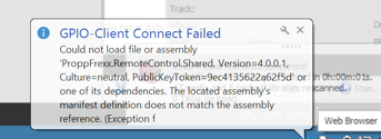

After updating to the latest versie (4.0.0.2) I get an error message from the GPIO Client.
Error GPIO-Client Connect.png (39.72 KiB) Viewed 6021 times
A friend of mine is getting the same error message on his machine. After doing a roll back of my virtual machine to to it's snapshot before updating,it's ok (but that's no news I guess)

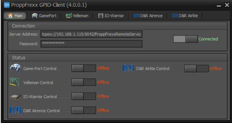

One thing I see: the error message states version 4.0.0.1. Also the main screen of the GPIO client is showing 4.0.0.1. So, maybe upgrading that particular application failed? Tried it several times.
As I don't use the GPIO Client on this machine, I am not able (at least not on this moment) to test if the GPIO Client is working ok. However, when I have a look at the interface, it shows that it is connected. No mentions in the PFOA error.log
GPIO Client interface.png (43.82 KiB) Viewed 6021 times

Re: Error message GPIO Client after updating to 4.0.0.2
No errors from any other user so far, but I'll take a look what this might be...
Yes, that was indeed a build error.
In the v4.0.0.2 I forgot to also rebuild the GPIO Client app - that's exactly what the error message tries to tell us ;-)
So please "Check for Updates...", a new v4.0.0.3 (re)build is available - where all apps and tools are now using the same version number again.
Sorry.
