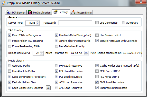

Is there something wrong to my MLS settings ?

Also I don't understand why the Node tag reader is working if MLS is doing it's job.

I do not know your MLS settings...
But yes, the MLS can handle the TAG reading, if enabled and transmitted to the client.
