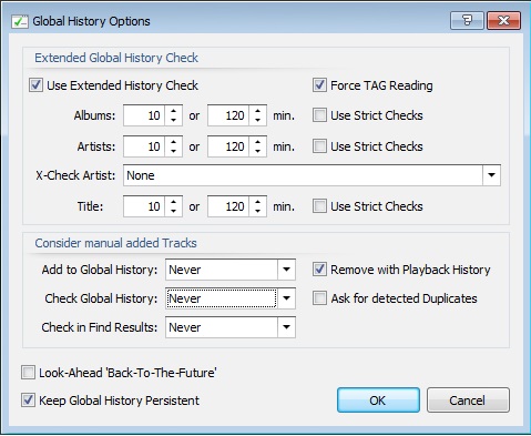

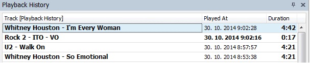

Hi Bernd.
Today I launched PF after some time and after a while I realised tracks are not chosen as they supposed to be, i.e. as you can see from attached printscreens whitney houston was played twice in very small period which should not happened according to global history options. Or is there anything else I should check and change after updates (I was not changing any setting for very long time)?
Thank you.
Thank you.
- Global History Options.jpg (63.3 KiB) Viewed 15051 times
- Playback History.jpg (37.54 KiB) Viewed 15051 times

Hi Bernd.
a) TAGs are set, as I mentioned I did not change anything for a long time a before everything was working fine.
b) SupressHistoryCheck is set only for jingles, not for music tracks.
c) Where could this option be set? I did not set anything like that. Global Song History is 500, Script History is set to 500, Media Library Song History is set to 0 (shall I set it to 500?), for individual libraries is set also to 0 (shall I set it to -1?).
d) Tracks are added only through scheduler, not manually.
e) As mentioned in d), playlists are generated through scheduler
f) I am only using LeastTimePlayed mode
g) Global Song History is set to 500

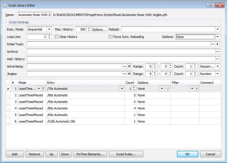

'UseLastTrackOnFinalFail' script option is not set as you can see from printscreen.
Regarding the history counts. Which one is better to use if I want to set it for example to 500 tracks? I have together around 3000 tracks in music library, but perspective libraries have different numbers of tracks.
- Scrip Library Editor.jpg (124.13 KiB) Viewed 15042 times

Re: Global History Options and songs added to playlist
I am pretty sure, that the history checks do work as expected, so I assume some other configuration issue.
It all depends on a few more factors (I can not check these from your screen shots):
a) Your audio files meta data TAGs (Artist, Title etc.) must be set - I assume this is the case.
If no TAG data is available the check can only be performed based on the filename; which is different I assume.
b) Your script-line might have the 'SupressHistoryCheck' option set.
In that case, no history check is performed.
c) Your script might have the 'UseLastTrackOnFinalFail' option set.
If you are using a media lib having less entries than your history (either your global, your script or media lib history - don't know, if you use those as well); it might be the case, that no entries can be found matching the history. If the 'UseLastTrackOnFinalFail' script option set; the last found entry is used regardless, which might violate the history.
d) You are adding tracks manually to a playlist.
As you haven't enabled those options in your global history options, these would not be checked.
e) You are using pre-prepared playlists (which have been created hours or days in advance).
f) You are scheduling those track via one of the following script-line modes: LoadTrack, LoadPlaylist, Execute, Advert, News, Container
Tracks scheduled via these modes will never be checked against any song history.
g) Your global history size is set to 0!
This would disable it completely.
Else that that it will not be possible.

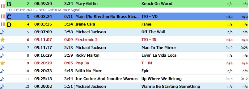

Unfortunately, it is not working, please, see printscreen. I have to be doing something wrong.
Please do the following:
a) validate from 'where' the 2 'Michael Jackson' entries are coming (as explained above via showing the SourceInfo column)
b) enable the Debug Logging - it should reveal some more info about duplicate playlist entries
c) Please send me the 2 or 3 'Michael Jackson' entries (the physical audio files) plus any related .pfmd files (if you are using them)
d) Please send me your script file (.pfs) you are using to take a look at
Once I received c) and d) we might do a TeamViewer session to take a look at your config!
