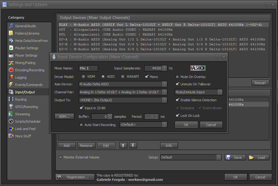

Hello,
i would like find the possibility to use only one channel insted of a pair.
My m-audio have on channel 1 and 2 the mic input.
Is already possible to use 2 channel separately?
Thk
Workino
Re: mono channel
No, currently not.
But I'll take a look to implement that into one of the next releases...
Re: mono channel
The new v3.0.11.46 now allows you to use real individual mono ASIO channels (once the 'Mono' option is checked)!
