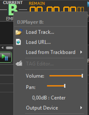

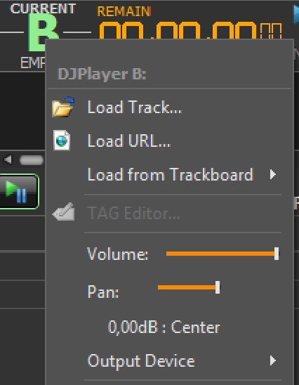

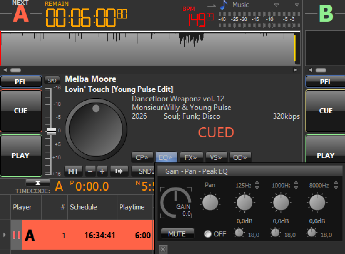

Re: Inconsistent Audio Levels Between Players After Latest ProppFrexx Update – Stereo Tool / Virtual Audio Cable
I am sorry, but this seems impossible and I can not even reproduce your issue. So the answer to your question is actually no, this can not be caused by a recent update.
The DJ Players are the exact same code and logic and can not play at different volumes.
But yes, you can set the Gain individually per track and also per DJ Player. Make sure they are not to improper values.
Try to eliminate any external source, e.g. StereoTools etc. and play the EXACT SAME audio file at different DJ Players WITHOUT any DSP or VST anabled and play them also tru a physical soundcard - then you will notice, that there is NO difference in the output level.
I.e. if you hear different tracks at different volumes, this must relate to your audio tracks or may be is related to your gain or StereoTool settings.
