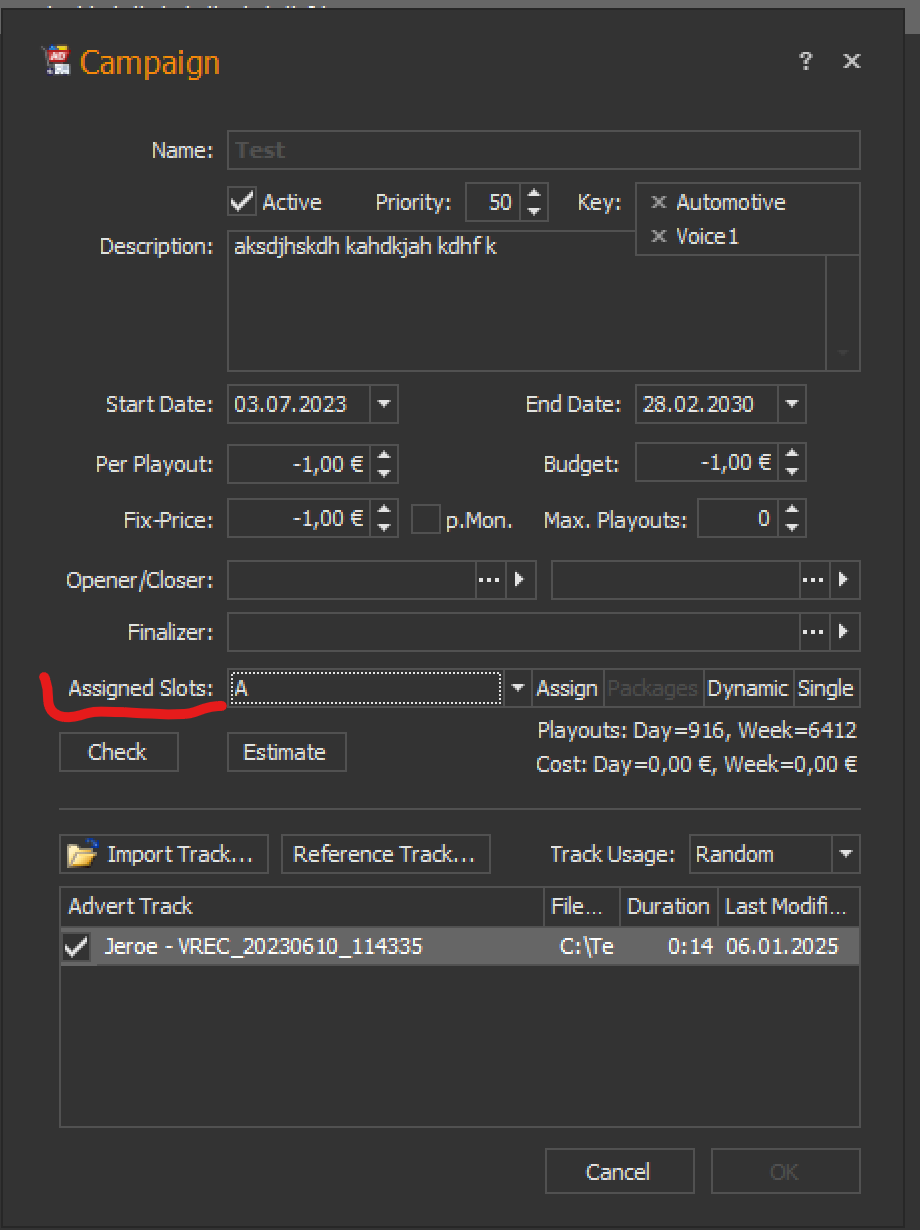

Depends on how you want to distribute/run the campaigns over time.
If the distribution can be fixed, i.e. the campaign run always at the same slots, you can simply assigned the respective Slots to that campaign:
This is a very simple and standard way. Else, if they must be dynamic (i.e. alter the slots for each day) you can proceed as you described. You will just get but ignore the warning. But, it might take a little longer to generate and assign the slots dynamically. You can also assign the dynamic slots in chuncks, e.g. 8 time 3 months (to generate slots for 2 years)...
But no, you can not just fill in 2 months and ProppFrexx would replan the rest for your automatically.
