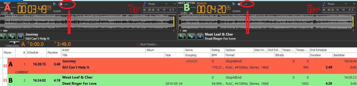

it can be easier with On a track, I've right-clicked and chosen "Track Settings" > "Toggle StopAtend option
see picture
click here on Track option
see picture
Re: Using as live studio playout software
Oh nice, thanks Tatje that's a quick shortcut to remember. Thank you
