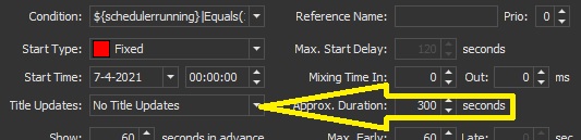

Why should you schedule a pre-recorderd program with a overlay why not on the regulare schedular?
By the way in te Overlay editor you can set the Title Updates

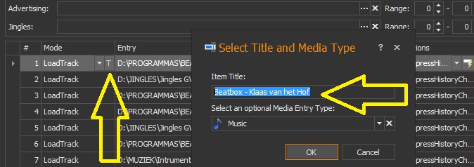

We schedule a pre-recorded program by the regular schedular. Then in the Script editor you can fill in the name off the show by click on the T. You have to fill this in only once.
Re: Programm schedule name
The macro ${progcurrentname} returns the name of the current program. See the Appendix of the User Manual, it contains all macro and their description.
The above solution is anyhow very good!
