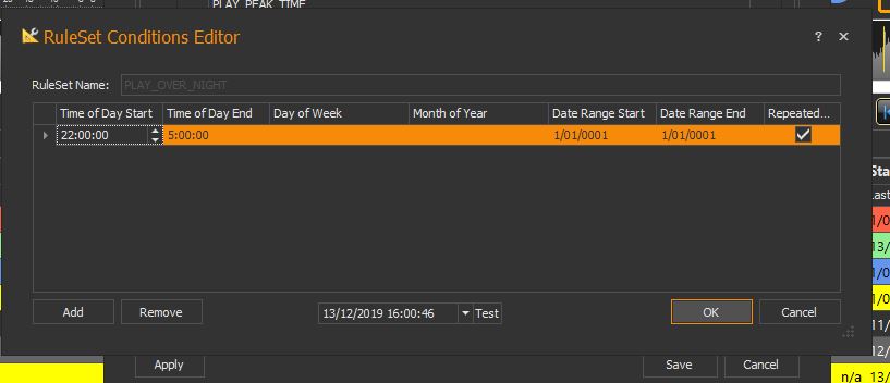

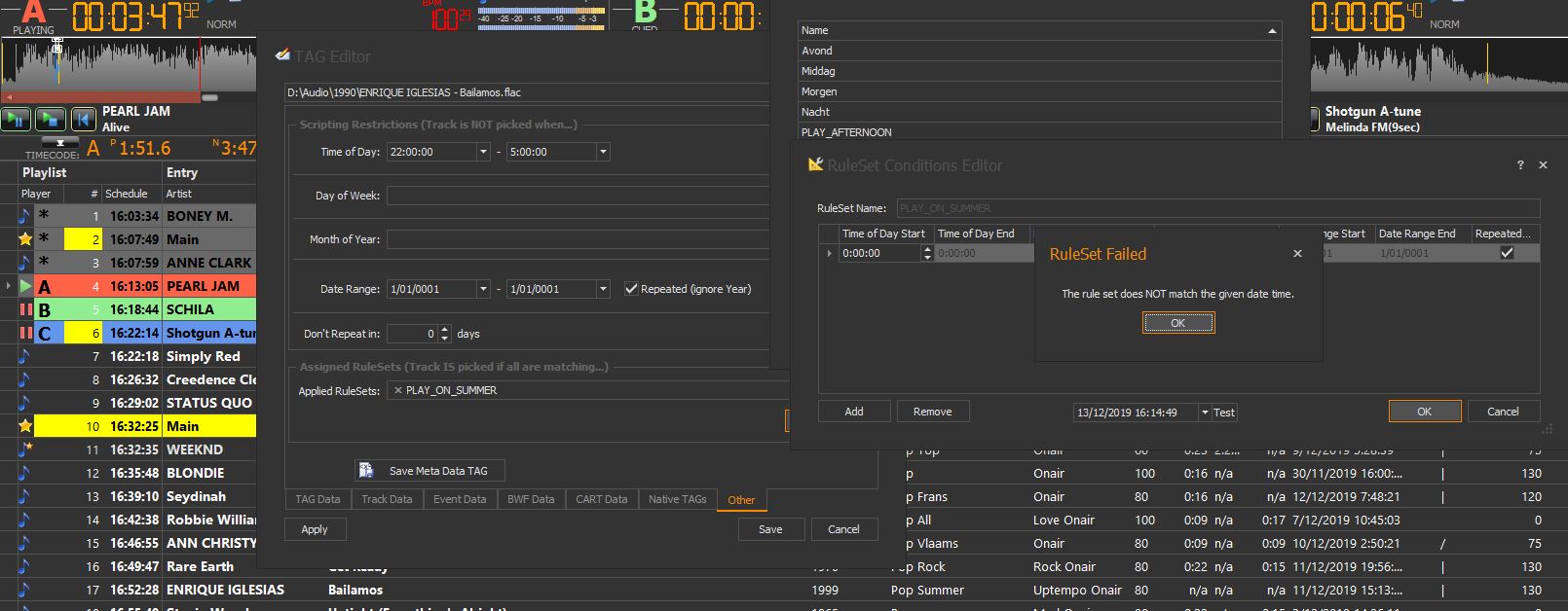

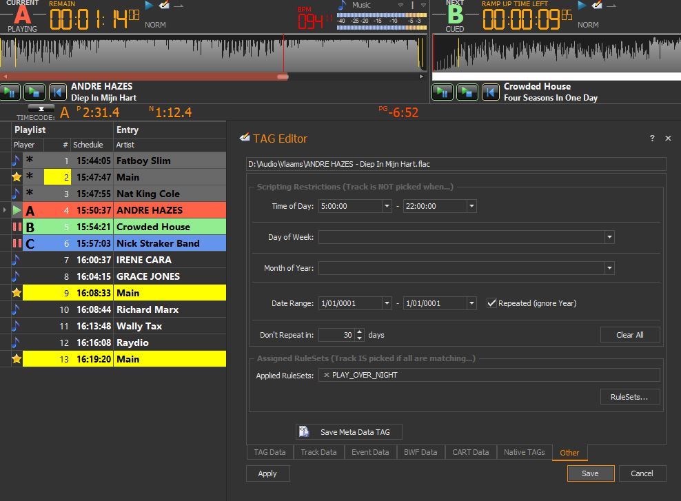

What is wrong here. The file is tagged so that he can play just overnight. Yet he played during the day. See screenprint.

I do not understand your last screenshot, as a time range from 0:00:00 to 0:00:00 wouldn't make sense.

It looks like you are using the 'UseLastTrackOnFinalFail' script option. Plus you have various histories in use and a filter per script-line.
As such, I assume, that for a particular script-line no track was effectively matching the history checks an the restrictions.
As such, the UseLastTrackOnFinalFail option took place and the last used/tested track was used - which then of course violates a rule.

That is the option you have already set. As said, it’s use means, that a script-line is not skipped, but instead the last tested Trackboard used (after all other tracks have been tried).
Use the ‚Test...‘ function to see what History might be reduced.
